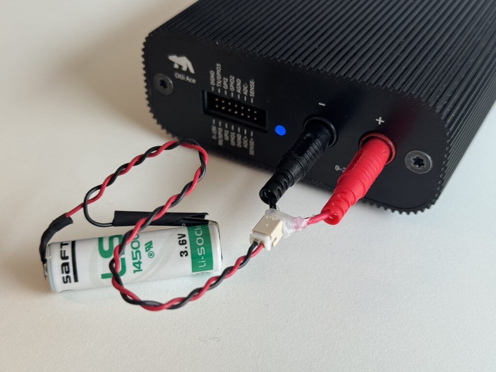

The battery is evaluated in a compact and scalable setup with Otii Ace Pro (see picture below), utilizing the Otii Battery Toolbox. The full step-by-step setup is explained and can be followed here.
The battery is tested with a battery connector connected to the banana connectors of the Otii Ace Pro.
Battery passivation measurement setup with SAFT LS14500 lithium thionyl chloride battery and Otii Ace Pro.
Battery passivation measurement setup with SAFT LS14500 battery and Otii Ace Pro.

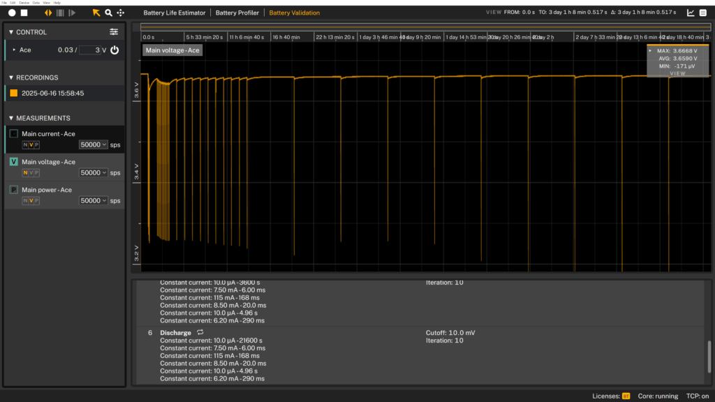

The recovery period is first set to 60 seconds between each LoRa pulse. After 10 pulses, the rest time is increased to 10 minutes, then 1 hour, and lastly 6 hours (21600 seconds).
To capture detailed data for this evaluation, the Otii Ace was configured with a sampling rate of 50,000 samples per second. Combined with the fact that the test runs continuously over several days, this results in a very large project file—in this case, nearly 150 GB. Make sure your system has sufficient storage capacity before running similar tests.
While it’s possible to reduce the sample rate and still obtain valuable insights, we recommend using at least 5,000 samples per second to ensure reliable results when analyzing fast transient behaviors.
Figure 1: Saft Li-SOCl₂ battery discharge with Otii Ace Pro for different battery recovery periods.

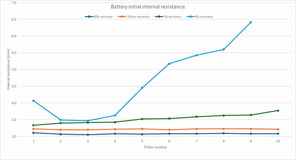

Since the LoRa transmission consists of multiple distinct current steps, there are several ways to approach the analysis. For this study, we focus on two key measurements:
  • Initial internal resistance of the battery during the wake-up phase, represented by the 7.5 mA current step.

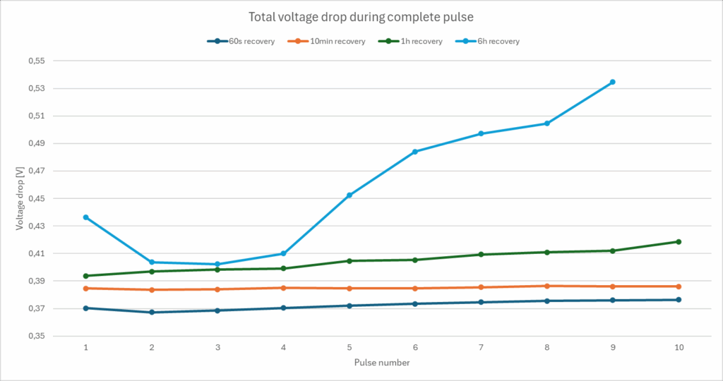

  • Total voltage drop during the full pulse, specifically when the current peaks at 115 mA for 168 ms.
For each of the 10 pulses recorded per rest period, we take the following voltage measurements:
  • V1: The initial voltage level before the pulse begins.
  • V2: The voltage after the 7.5 mA step.
  • V3: The minimum voltage observed during the full 115 mA pulse.
The initial internal resistance is then calculated using Ohm’s Law:
R = V / I where V = V1 – V2 and I = 7.5mA
Note: Actually I = 7.5mA – 10uA but 10uA<<7.5mA and can be neglected.
This approach allows us to track how internal resistance and voltage stability evolve with increased rest time and passivation effects.
As shown in Figures 2 and 3, the results exhibit a consistent trend. With 60 seconds and 10 minutes of recovery time, the passivation effect is minimal. However, at 1 hour, signs of passivation begin to emerge. By 6 hours, the effect becomes noticeable, indicating a significant increase in internal resistance and voltage drop due to prolonged rest.
Battery passivation effects of SAFT LS14500 lithium thionyl chloride battery.
Figure 2: Initial internal resistance of the battery during the wake-up phase, represented by the 7.5 mA current step.
Figure 3: Total voltage drop during the full pulse, specifically when the current peaks at 115 mA for 168 ms.
The deviation observed in the first data point for the 6-hour recovery period may be due to environmental conditions during the test. Specifically, the air conditioning in the lab failed, causing the ambient temperature to rise to nearly 30 °C, which could have affected the battery’s behavior.
