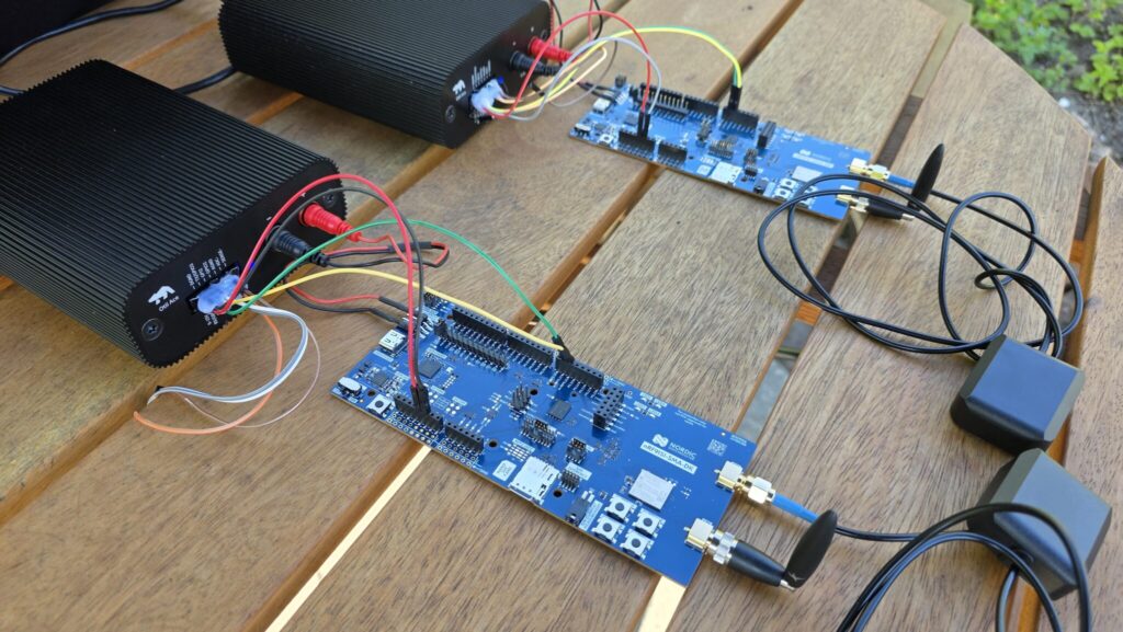

The NTN and cellular connectivity setup
For the terrestrial network we used Soracom, a global IoT connectivity provider. For the NTN connectivity we used Monogoto, which routes traffic via the Skylo IoT satellite service operating on S-band (Band 256). The satellite is a GEO satellite in a fixed position above the equator, meaning that from our location in Lund, Sweden, it sits roughly 30° above the southern horizon. A clear view to the south is therefore essential for a reliable connection.
Both boards were connected to Otii Ace Pro units for measurement and control:
  • The nRF9151 power rail is connected to the Otii Ace Pro main channel (banana connectors) — this is the path we measure.
  • A separate 5 V supply from the Otii Ace Pro 0–15 V pin (with DGND) powers the rest of the nRF9151-SMA-DK board, which needs power but is not part of what we want to measure.
  • UART TX and RX are connected to the Otii Ace Pro UART, enabling us to both monitor AT command output and control the boards programmatically.
One thing to be aware of: with the SLM application running, the UART block is always active, which adds a baseline of just under 600 µA to all current readings. This was characterised in the two previous articles. In a real product, the application runs directly on the modem and there is no UART overhead — so for real-world comparisons and absolute values to calculate battery budget, roughly 600 µA should be subtracted from all values. We will show both the measured values as well as the compensated values.
Both boards were configured with PSM using a 1-hour TAU timer and a 2-minute active window.
Because the GEO satellite is positioned above the equator, we had to go outdoors and find a location with an unobstructed view to the south — the satellite appears at roughly 30° elevation from Lund. Indoor or north-facing environments will not work.

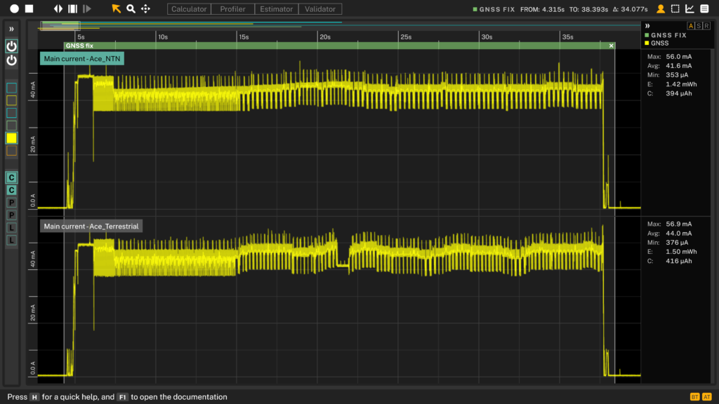

The comparison is broken into three phases: GNSS fix, network registration, and data transmission.
GNSS fix
Getting a GNSS fix is only strictly required for the NTN path — the modem needs to know its location to determine which satellite to connect to. For terrestrial IoT, this step would normally be skipped entirely. We included it here as a separate, clearly isolated phase so that the cost is visible.
In this test the GNSS fix took approximately 34 seconds and consumed between 1.4 and 1.5 mWh. This is a one-time cost per wake cycle for the NTN board, and has no equivalent on the terrestrial side. If we compensate for the UART consumption, we will get in average 1.4 mWh

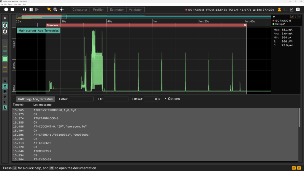

The terrestrial registration via Soracom was fast and unremarkable:

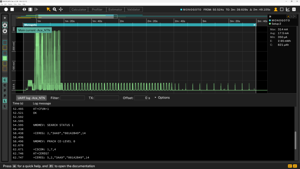

The NTN registration via Monogoto/Skylo looked noticeably different:

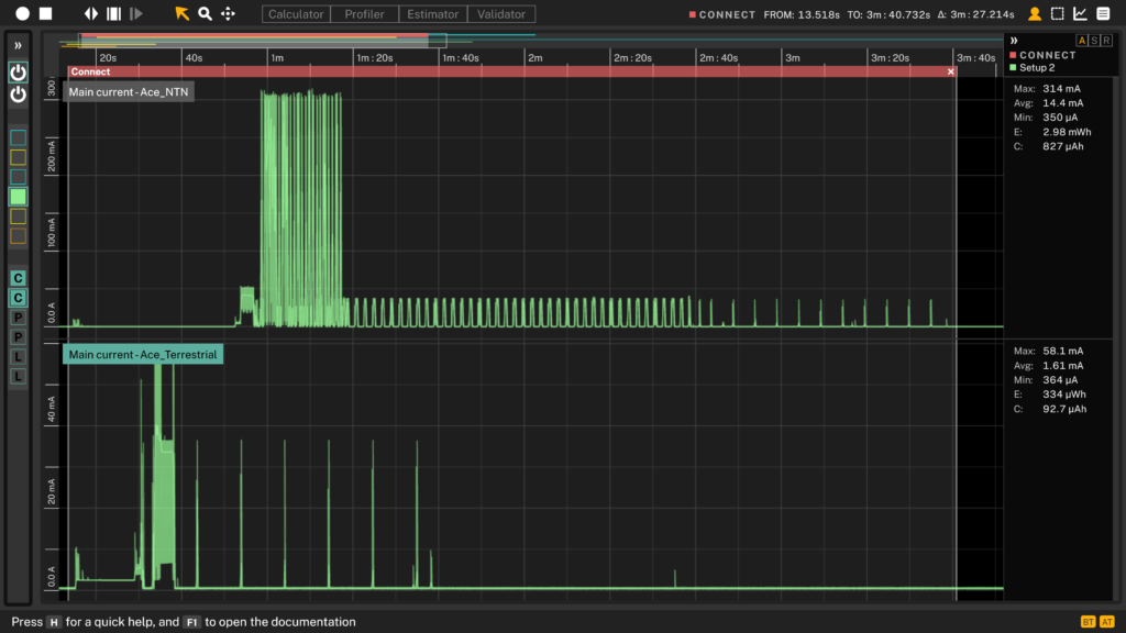

And side by side the difference is striking:
EnergyCompensated
Terrestrial (Soracom, NB-IoT)266 µWh213 µWh
NTN (Monogoto/Skylo, S-band 256)2.95 mWh2.85 mWh
The NTN registration cost more than 13× the energy of the terrestrial equivalent.
Important note: This is a 1:1 comparison that does not account for use case differences and setup variations in data transmission across these connectivity options. In practice, NTN deployments typically optimize transmission by batching data—for example, sending once per day rather than hourly—which significantly reduces power consumption and brings performance closer to hourly terrestrial transmission. See our upcoming article for a detailed comparison of battery selection and lifetime estimation for NTN and terrestrial applications.

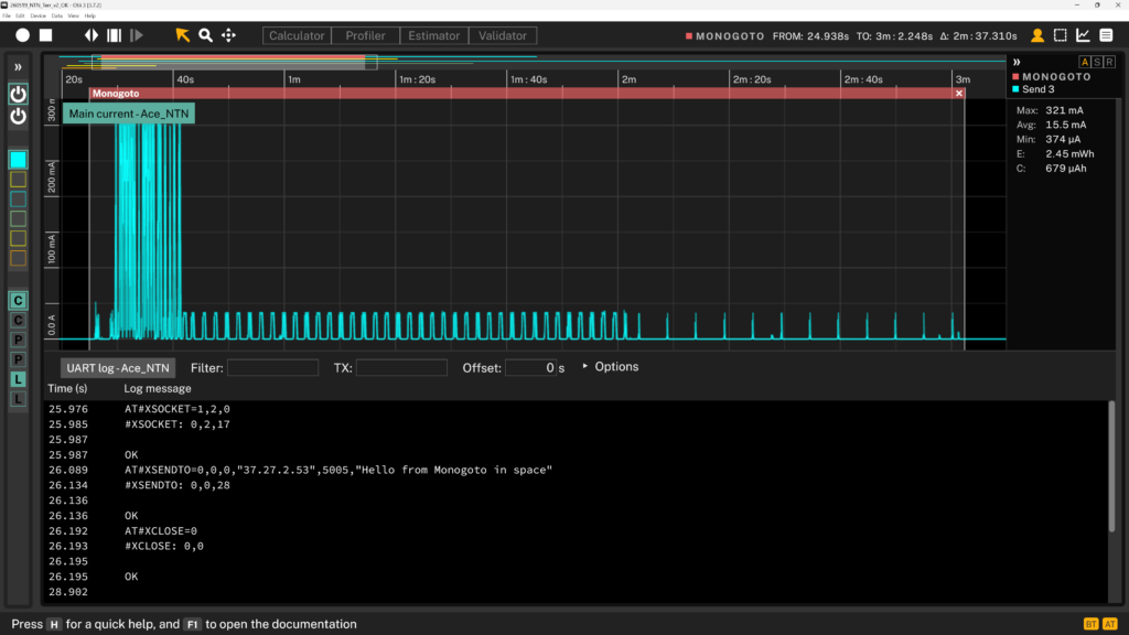

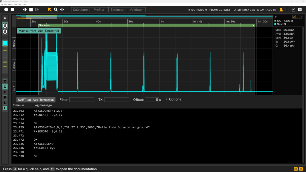

Data transmission
With both boards registered, we sent a UDP packet to our server. The terrestrial board sent “Hello from Soracom on ground” and the NTN board sent “Hello from Monogoto in space” — both 28 characters.
EnergyCompensated
Terrestrial (Soracom, NB-IoT)203 µWh163 µWh
NTN (Monogoto/Skylo, S-band 256)2.45 mWh2.35 mWh
Again roughly 14× higher for the NTN path. It is also worth noting that during NTN transmission the current peaks reach several hundred milliamps. With a sample rate of 1000 samples per second, the actual peak currents are likely even higher than what the statistics show — important to keep in mind when sizing your energy storage and power source.
