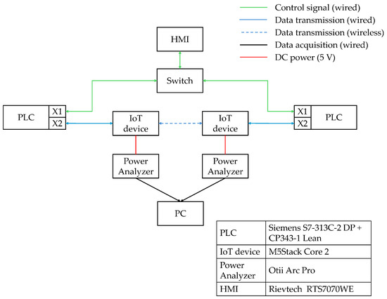

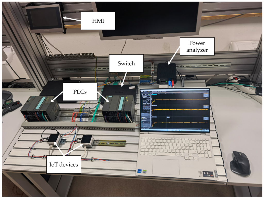

The testbed, built at the Laboratory of Cyber–Physical Manufacturing Systems at Széchenyi István University, centers on two Siemens S7-300 PLCs — one sending, one receiving — each wired to its own ESP32-based M5Stack Core2 gateway. The gateways are hardwired to their PLCs but communicate with each other wirelessly; that link is what the study measures. An HMI handles measurement control over a separate wired connection, kept apart from the data path itself.
Each gateway – highlighted as an IoT device – is powered and measured using an Otii Arc Pro, with accuracy of ±(0.1% + 50 nA) and ±(0.1% + 1.5 mV). GPIO signals mark the exact start and end of each transmission, feeding into the profiler so active transaction energy can be cleanly separated from standby draw.
Each protocol was tested using its default configuration with four different payload sizes: 50, 500, 5,000, and 15,000 bytes, chosen to span the range from small periodic telemetry to bulk diagnostic transfers.
