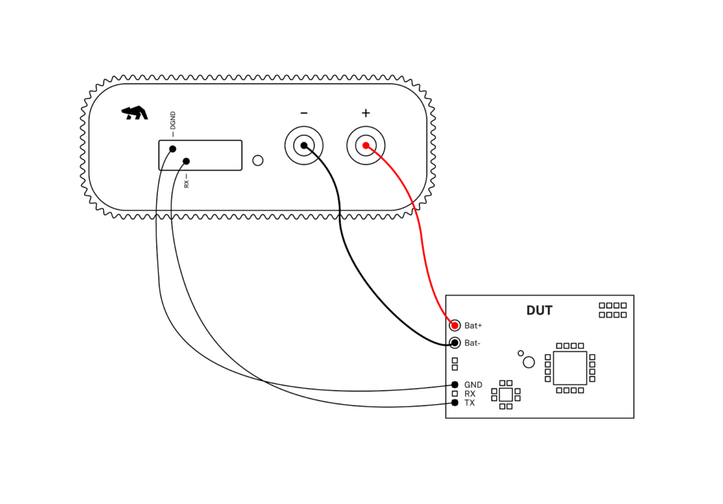

To ensure a fair and reproducible comparison, a standardized testing pipeline was implemented. The Device Under Test (DUT) is an ESP32-C6 Development Board, powered at a constant 3.6V by the Otii Ace power profiler. Data were captured across four synchronized channels: Main Current, Main Power, Main Voltage, and UART RX.
Fig. 1. Device under test (DUT) connection with Otii Ace and UART synchronization

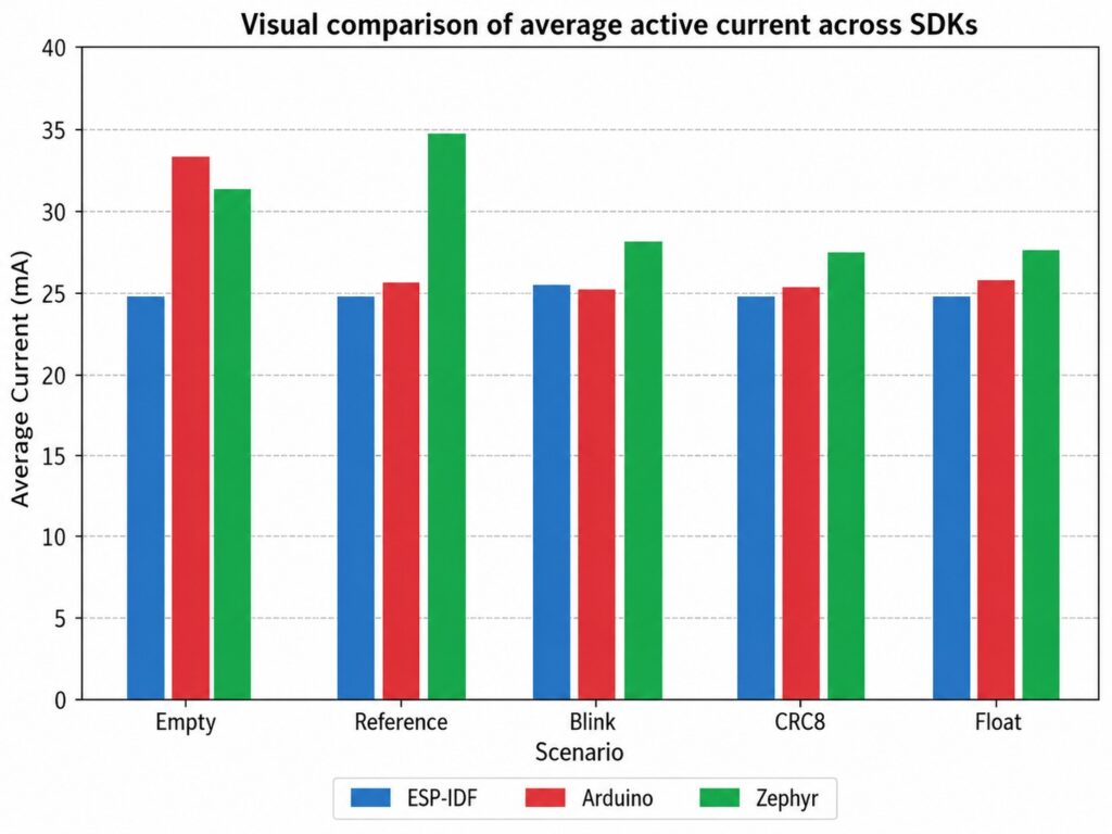

The following table and subsequent chart summarize the average current consumption across all tested scenarios.
Comparative Current Consumption (Average mA)
Scenario ESP-IDF Arduino Zephyr
Empty (Baseline) 24.77 33.57 31.53
Reference (UART) 24.75 25.63 34.77
LED Blink 25.50 25.35*28.31
CRC8 Calculation 24.77 25.35 27.57
Float Multiply 24.77 25.79**27.56
* Note: Arduino showed marginally lower consumption than ESP-IDF in the Blink test, likely due to its -Os compiler optimizations generating tighter instruction loops for simple GPIO wrappers.
** Note: Value heavily influenced by a software exception (Stack Overflow).
Technical discussion and code analysis
The native advantage: ESP-IDF
The results confirm that ESP-IDF provides the most consistent power profile. Across computational workloads (CRC8 and Float), consumption remained stable at approximately 24.77 mA. The combination of native FreeRTOS vTaskDelay, superior peripheral clock gating, and the advanced GCC 14.2.0 compiler allows the core to execute instructions faster (via -O3) and return to idle states more efficiently than the abstracted SDKs.
Arduino’s “Empty” anomaly
A significant observation is Arduino’s Empty Scenario (33.57 mA), which consumes  35% more current than its active workloads ( 25.3 mA). This counter-intuitive behavior suggests that Arduino’s init() sequence leaves background services (such as the radio stack or specific high-speed clocks) in an active waiting state unless explicitly managed by user code. It highlights that an idle loop in Arduino is energetically detrimental.
Zephyr’s RTOS abstraction tax
Zephyr maintains a consistently higher baseline across all active tests (+2 to +3 mA compared to IDF). This is the current consumption cost of hardware abstraction and a highly modular RTOS scheduler. While Zephyr offers unparalleled portability across different silicon vendors, developers must account for an approximate 10-12% reduction in battery life for simple, single-task workloads compared to native development.

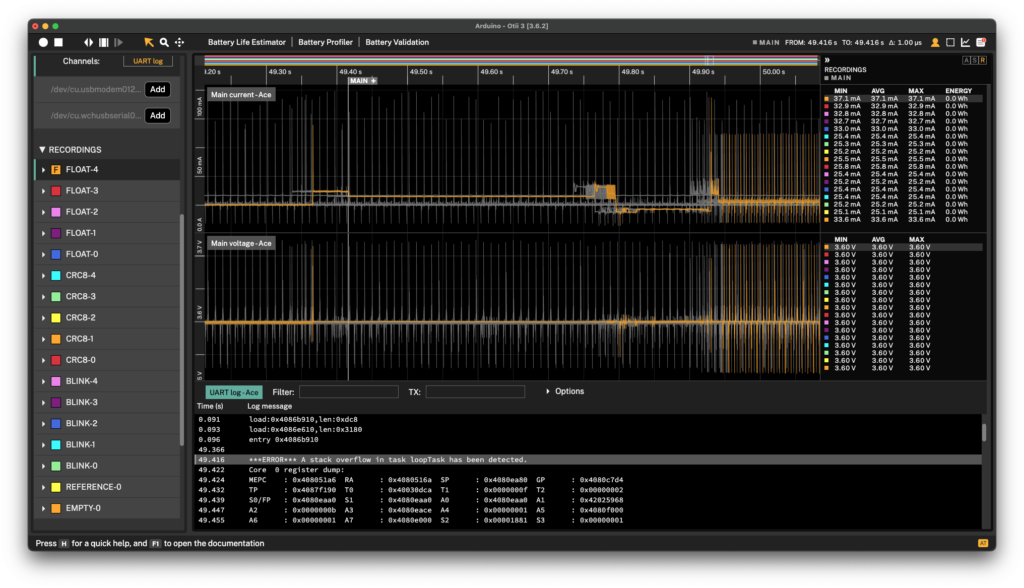

The 49-second crash: Software robustness as energy efficiency
During the Arduino Floating-point test, a consistent system failure was captured. Across all 5 iterations, the system triggered a Stack Overflow consistently between 49.38 s and 49.41 s.
Fig. 3. Stack overflow event at 49.416 s captured during the Float test.
By correlating the UART timestamp with the power profiles, current spikes were observed immediately prior to the crash. A Root Cause Analysis (RCA) of the Arduino code revealed two critical developer errors:
  1. Format String Misuse: Using Serial1.write(“%.4f”, result); instead of a formatted output function, leading to undefined pointer arithmetic on the stack.
  1. Missing Return Statement: A non-void function lacking a return statement, causing progressive stack frame degradation.
This event demonstrates that software bugs are not just functional failures; they are energetic events. The exception-handling routines prevented the System on Chip (SoC) from maintaining its nominal execution current, proving that code stability is a strict prerequisite for “Green Computing”. This suggests that power profiling can serve as a side-channel for detecting software instability.
