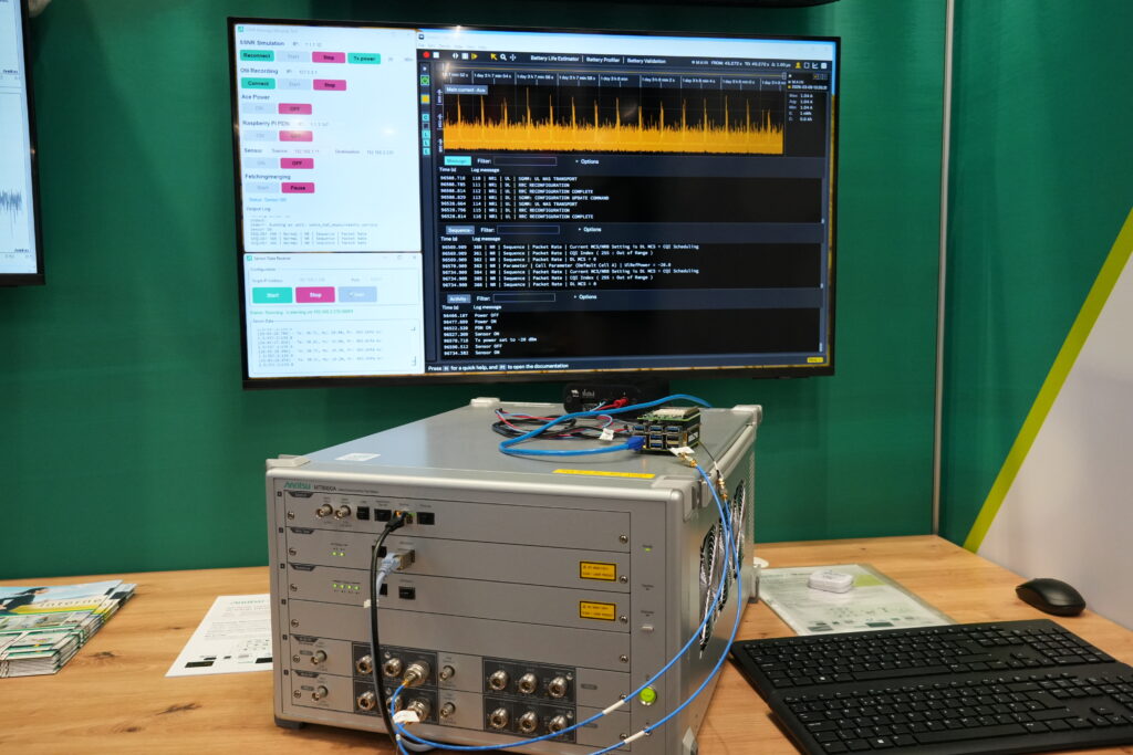

Otii Ace Pro and Anritsu MT8000A setup power measurement sync with network behaviour.

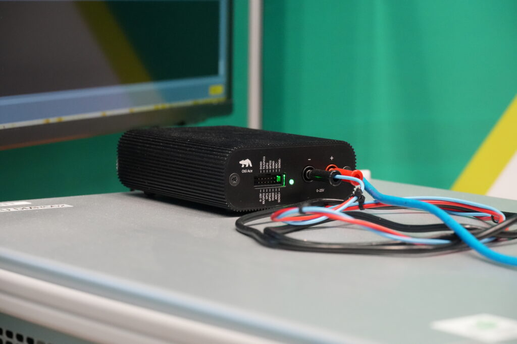

Otii Ace Pro – power profiler with real-time import log functionalities.

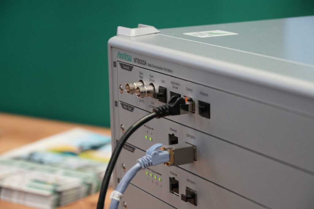

Anritsu MT8000A base station tester provides the means to change cellular network parameters.

Text-based logs from the MT8000A can be imported in real time while a DUT is being measured under specific network parameter settings. Using a Python script and the Otii API, logs from the MT8000A are read and visualized in the Otii Desktop App via the Otii TCP Server. This creates an additional measurement channel in your Otii project that displays network events, connection states, transmission bursts, sleep cycles, and protocol messages, all synchronized with their corresponding power measurements, see picture below. This application note explains in detail how to execute this import and includes an example Python script to get you started.
Signalling logs synced from Anritsu’s MT8000A and aligned with power measurements in the Otii Desktop App. The effects of TX power changes on DUT power consumption are shown.
