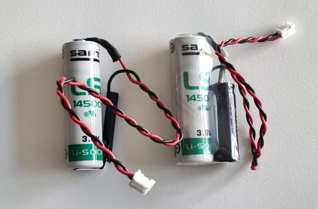

  • Saft LSP14500, 3.6 V. LSP refers to a hybrid lithium primary battery that combines a lithium thionyl chloride cell with a lithium-ion capacitor (LIC) in parallel.
We initially started with two packs of LSP14500. To make a comparison, we opened one of the LSP14500 packs and removed the super capacitor, allowing us to measure only the LS14500.
During battery handling, great care is taken to ensure the cells are not connected in any way, preserving their unused state since manufacturing. Extra caution is exercised when opening the battery pack to avoid any risk of short circuits. This process has been conducted in a professional laboratory environment, and it’s a critical practice that should be carefully considered when working with any battery.
Both batteries were manufactured in December 2020 and remained unused.
Saft LS14500 and LSP14500 batteries were tested for passivation effects after long storage time.

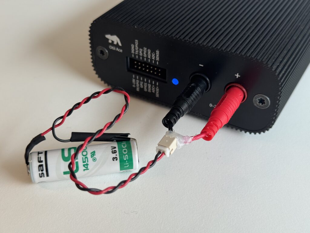

The batteries are evaluated in a compact and scalable setup with Otii Ace Pro (see picture below), utilizing the Otii Battery Toolbox. The complete step-by-step setup is explained and can be followed here.
Both batteries are tested in the same way, with a battery connector connected to the banana connectors of the Otii Ace Pro. The same cable length is also used.
Battery passivation measurement setup using a SAFT LS14500 battery and an Otii Ace Pro.

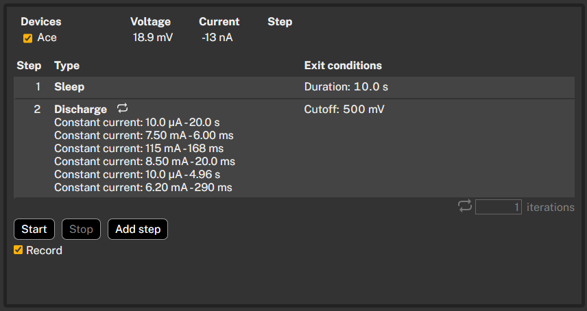

Most utility meters with wireless communication globally use one of the following technologies: Wireless M-Bus, NB-IoT, LTE-M, or LoRaWAN. For this exercise, we chose to investigate the passivation effect, assuming a LoRaWAN device and a typical LoRaWAN discharge profile.
The discharge profile is selected for LoRaWAN spreading factor 9 (SF9), with a sleep current of 10 μA for 20 seconds.
The discharge profile is simplified to:
  • 10uA for 20s (sleep period)
  • 7.5mA for 6ms (wakeup)
  • 115mA for 168ms (TX)
  • 8.5mA for 20ms (post TX)
  • 10uA for 4.96s (sleep, waiting for RX)
  • 6.2mA for 290ms (RX)
The profile is iterated for 20 minutes to investigate the battery behaviour over time.
The battery discharge settings in Otii Battery Validation reflect a power profile for LoRaWAN communication.

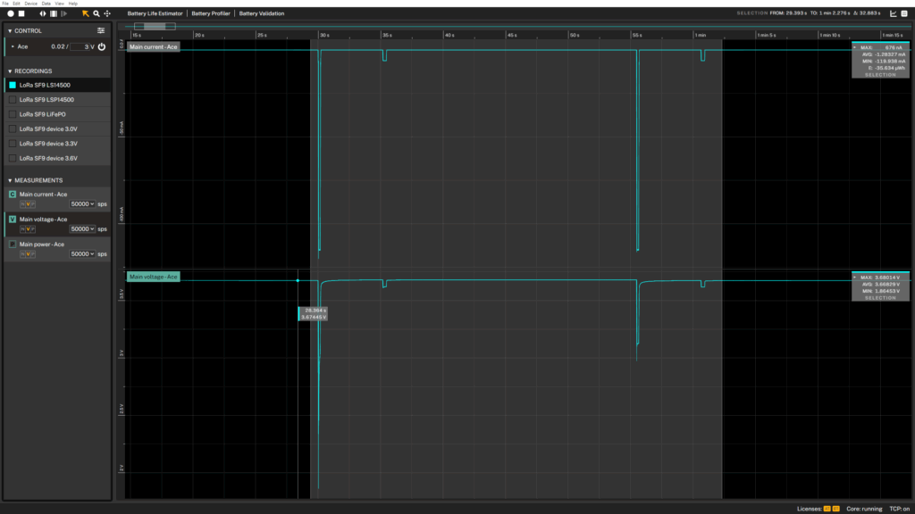

Fig. 1 Discharged Saft LS14500 battery with noticeable battery passivation effects at the first pulse after long storage time.
It is observed that the first pulse is affected by an initially elevated internal resistance, caused by the buildup of the passivation layer during the 4.5 years of storage, as shown in Fig. 1. At the start of the first pulse, the internal resistance exceeds 100 ohms. For the second pulse, it drops to approximately 15 ohms. From the third pulse onward, the internal resistance stabilizes in the range of 3.5 to 5 ohms.
Voltage drops due to passivation have been observed as high as 1.8V. For devices powered by 3.6 volts, such drops can lead to device resets or shutdowns, directly affecting the product’s operability and longevity.

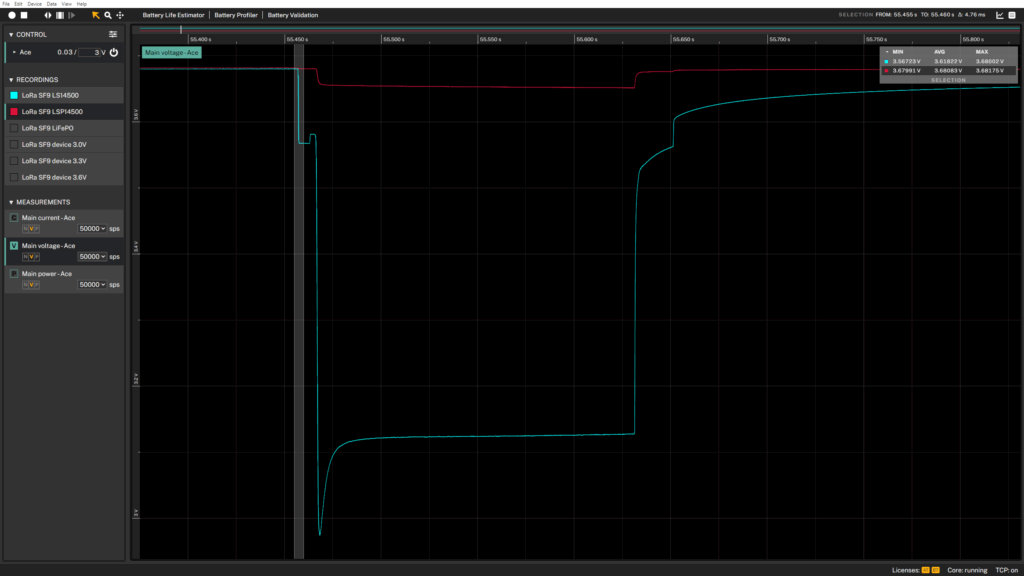

The passivation effect has been mitigated by the super capacitor connected in parallel, as shown in Fig. 3. The super capacitor absorbs the high pulse when the device enters active mode, maintaining a stable voltage while the passivation layer disappears.
Fig. 3 Comparison of Saft LS14500 and LSP14500 battery passivation effects during the first pulse after long storage time.
