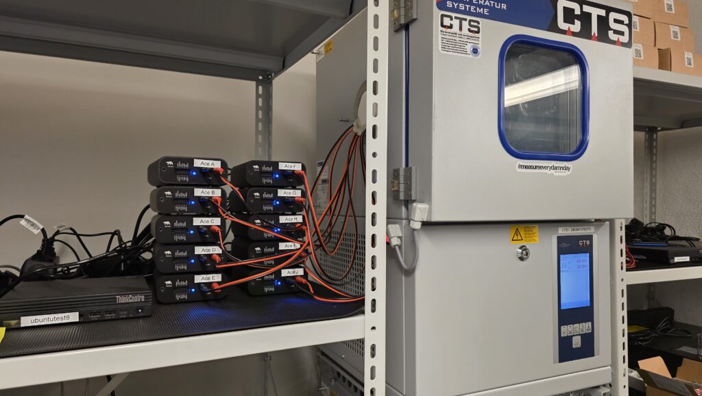

All batteries were discharged at 25°C in a temperature-controlled chamber (optional, but it removes environmental variations). They were not brand new, stored for 1–2 years, so some self-discharge had occurred. However, since all brands were treated equally, the comparison remains valid.

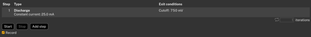

- Constant Current (25 mA) – The reference measurement

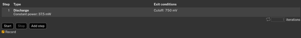

2. Constant Power (37.5 mW) – Equivalent to 25 mA at 1.5 V, but current increases as voltage drops

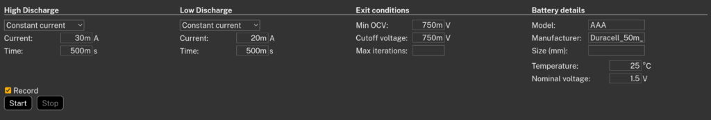

3. Pulsed 1 (30 mA / 20 mA alternating every 0.5s) – Average 25 mA, simulating moderate activity variation

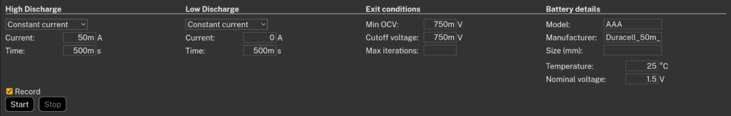

4. Pulsed 2 (50 mA for 0.5s / 0 mA for 0.5s) – Average 25 mA, simulating active/sleep cycles

The Otii battery testing setup
The setup was simple:
- Instrument: Otii Ace Pro units connected to a PC (it can be either Windows, macOS, or Ubuntu operating system)
- PC Software: Otii Desktop App with Otii Battery Toolbox license (Battery Validation + Battery Profiling)

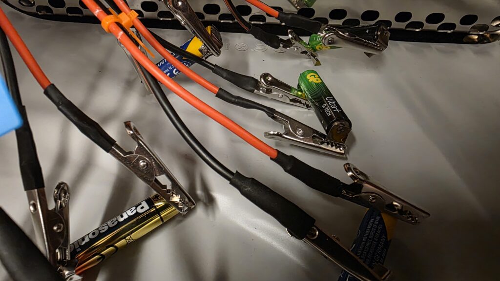

- Battery connections: Batteries spot-welded to metal strips (to reduce resistance), no holders used

- Battery Validation was used for constant-current and constant-power discharges. It allows fully customizable discharge patterns, including complex pulse trains or even cycling tests for rechargeable batteries.
- Battery Profiling was used for pulsed discharges. It alternates between high and low loads, calculating internal resistance and open-circuit voltage during the test. Results are stored in a battery profile file that can later be used for analysis or even for battery emulation.
