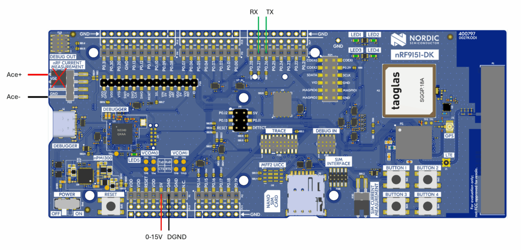

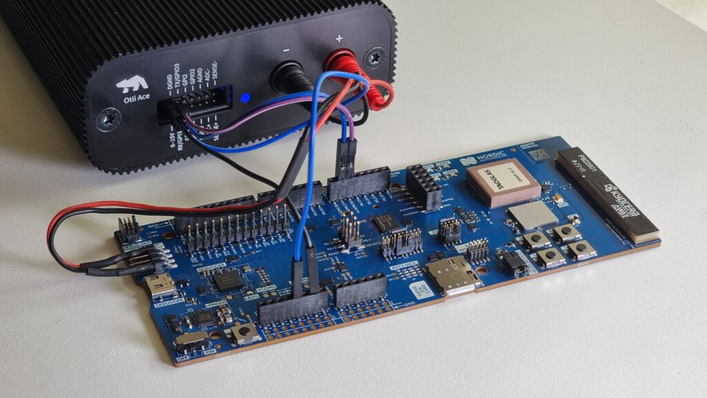

Here is how to connect the Otii Ace and the nRF9151-DK board (the names of the connections are the pins on the Otii Ace):
Remove the jumper where Ace+/- is going to be connected. In this setup, Otii Ace’s main channel will power and measure the VDD of the nRF9151-DK, and the 0-15V pin will power everything else on the board. The board can also be powered by using the USB power, but using the 0-15V pin makes it possible to do a power cycle of the board if needed. NOTE! If you choose to power via USB, DO NOT power 0-15V to the 5V pin.

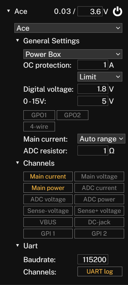

In the Otii desktop application, set the following:
- Main voltage between 3.0 and 5.5V
- Overcurrent 1A
- Digital voltage 1.8V
- 0-15V set to 5V (must not exceed 5.5V) If 0-15V connection is used, USB MUST NOT BE PLUGGED IN!
- Enable
- Main current
- Main voltage
- UART log
- Set Baudrate to 115200

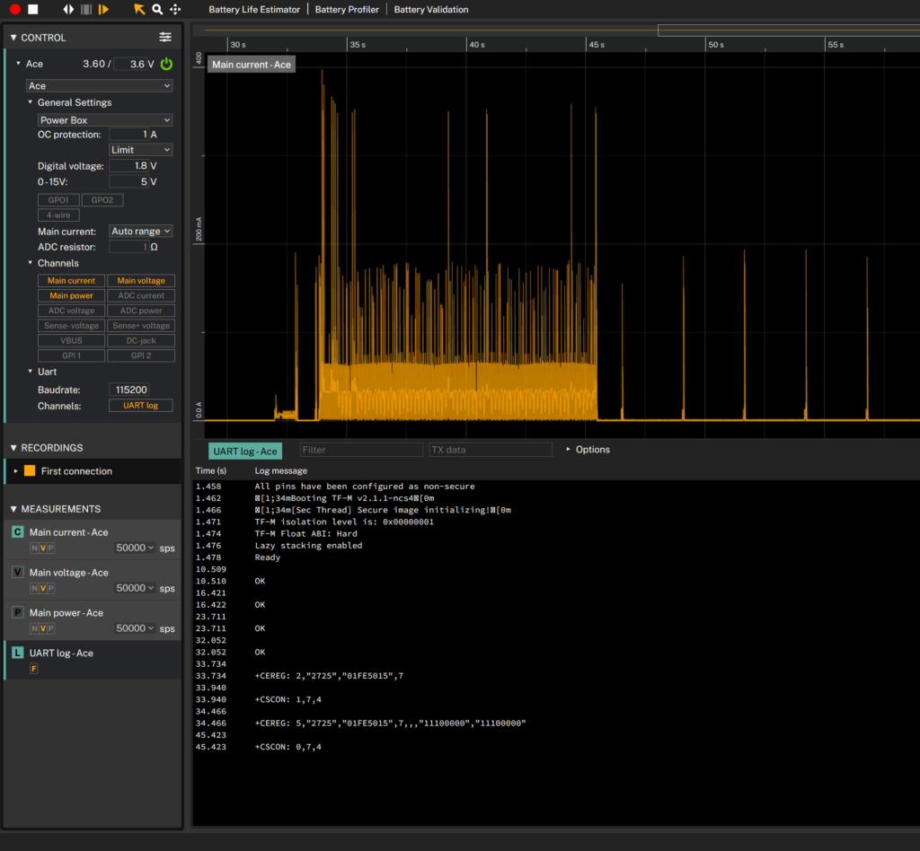

The Nordic nRF9151-DK board will now start. In the UART log in the Otii app, a response of “Ready” will appear when the board is up and running. Once ‘Ready’, the board is in AT command mode, and can be controlled by sending AT commands via the Otii app. When an AT command is accepted, the response will be “OK”. All AT commands can be found here.
The radio is turned off by default when the board is started. To send AT commands, enter the commands in the TX data field above the UART log in the Otii app. The response will be visible in the UART log.
Here is how the AT commands procedure on the nRF9151-DK for LTE-M eDRX power saving mode appears in the UART log of the Otii app, along with the measured power profile.

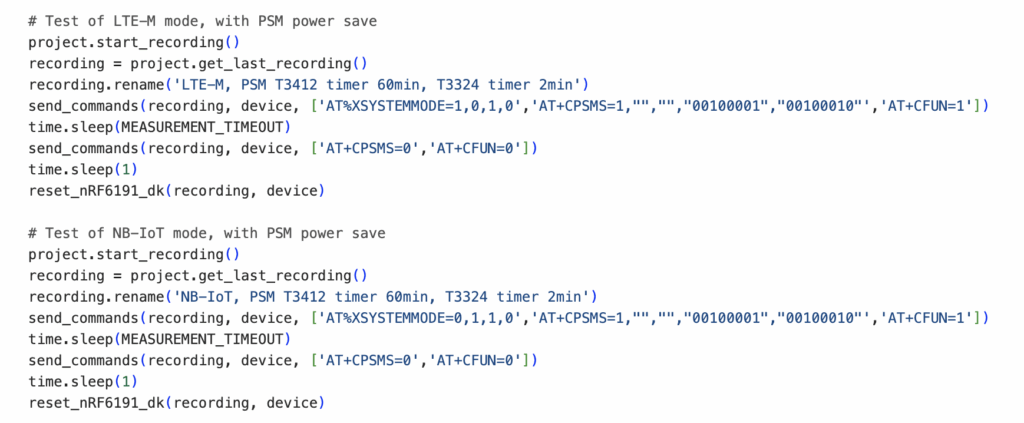

The tests can be performed manually or automated. In this study, we opted for automated tests since the testing involves many possible configurations, and automation makes the process easier. We used Otii Automation Toolbox and a Python script that can be downloaded from Qoitech’s GitHub here.
The configurations that we tested are:
- LTE-M mode, with no power save modes
- LTE-M mode, with eDRX power save
- NB-IoT mode, no power save
- NB-IoT mode, with eDRX power save
- LTE-M mode, with PSM power save
- NB-IoT mode, with PSM power save
- LTE-M mode, with eDRX and PSM power save
- NB-IoT mode, with eDRX and PSM power save

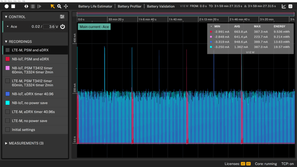

LTE-M power modes

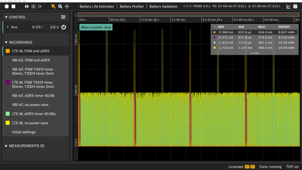

In the top-right corner of the graph, the statistics show the average current consumption over one hour of measurements for various LTE-M configurations, both with and without power-saving modes.
As shown, enabling eDRX significantly reduces power usage from approximately 1.15 mA to approximately 710 µA.
Activating PSM lowers it even further, from ~710 µA to ~630 µA.
We used both eDRX and PSM together and measured the lowest current consumption at approximately 623 µA. The improvement over PSM alone was minimal, but the majority of this current consumption is the UART block that is enabled, consuming roughly 600uA.
NB-IoT power modes
We performed a similar comparison using NB-IoT to observe the step-by-step impact of enabling power-saving modes.
With eDRX enabled, the average current consumption dropped from approximately 1.36 mA to 950 µA. Enabling PSM further reduced the current to around 640 µA, the lowest observed value. Note again, the ~600uA UART consumption.

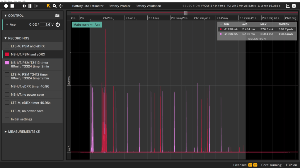

Interestingly, combining eDRX and PSM resulted in a slight increase to approximately 660 µA. This rise is noticeable when zooming in on the second and third modem wake-up cycles, see the graph below.

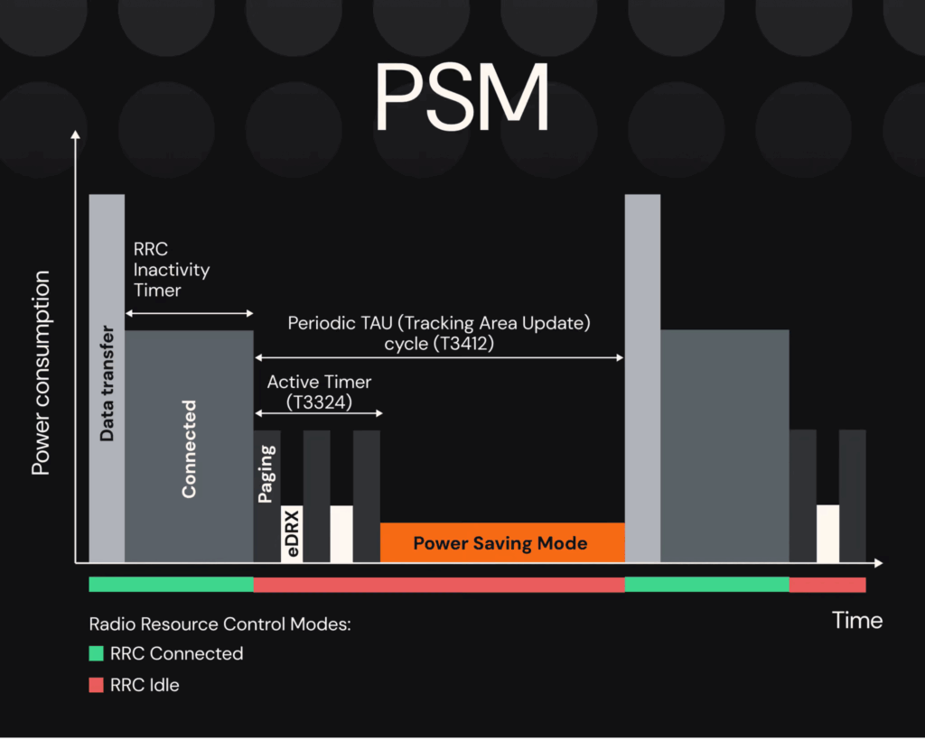

We did not further investigate the cause of this behavior. When using PSM and eDRX together, the device first enters eDRX mode, where it sleeps and periodically wakes to check for downlink messages (see image below). After the T3324 Active Timer expires, the device transitions to PSM, a deep sleep state where it becomes unreachable to the network but remains registered. It stays in PSM until the T3412 timer expires (Periodic TAU) or it needs to transmit data. This combination allows a balance between downlink accessibility and maximum power savings. However, not all networks support both modes simultaneously, and improper configuration—such as overly frequent eDRX cycles—can increase power consumption. It’s crucial to test and measure performance in your specific network environment.
