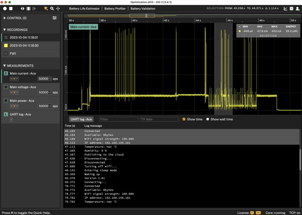

An exceptional feature of Otii Arc/Ace Pro is its ability to correlate UART messages with the power consumption graph. When you mark a specific area on the current graph, all the UART messages that occurred within that time-frame are highlighted in the UART log. Additionally, you can also reverse this process by marking one or multiple messages in the UART log, which will then highlight the corresponding time-frame on the current graph. This feature provides you with invaluable insights into how your device’s code execution affects its power consumption.

Step 3: Configure the Digital voltage level for your device in the General Settings within the Otii application. Enable the UART channel and choose the correct Baud rate for your device.
Configuring these settings correctly ensures that Otii Arc/Ace Pro can accurately capture and interpret UART data from your device.
Step 4: Power profile and analyze the UART prints.
Once you’ve completed the setup, you can start analyzing the UART data. The UART prints will be displayed in real-time within the UART log window. You can choose to view the data with relative time, wall time or no time.
UART log are synced with power measurements collected with Otii hardware.
Step 5: Copy the UART records.
If you need to save or share the UART records for further analysis or documentation, simply select one or multiple messages, and you can copy them using the standard keyboard shortcut (Ctrl-C/Cmd-C) or by right-clicking and selecting “Copy log.”
